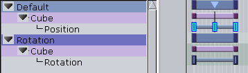

To Run the Animations Independently
Create a Director at the root level of the Stage Tree.
Rename the new Director to Rotation.
Drag the rotation channel to the new Director.
The Stage Tree and should now look like this:When playing the animations now, the output depends on which Director is selected. If the Default Director is selected, only the position animation will be played. If the Rotation Director is selected, only the rotation animation will be played. Selecting both/all Directors will play both the position and rotation animations.
