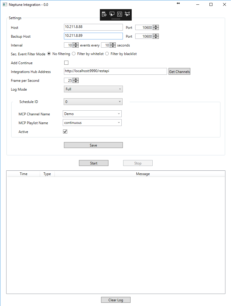

Before you start the PB Neptune integration module, you must collect some details from your local Viz Multichannel and PB Neptune administrators. In particular, you will need the network address (or IP-address) of Neptune servers and the hostname where the Integrations Hub is installed. The required information is shown in the screen-shot below.
Form Input
Description
Host
Neptune server host name/IP and port number.
Backup Host
Backup Neptune server host name/IP and port number.
Schedule ID
Index of Schedule from Neptune server, starting from 0, up to 20.
Set the channel and playlist per schedule ID. You activate the schedule by selecting an active schedule (only schedule IDs that are active are displayed).
Interval
Number of events sent to MCP, and loop time in seconds. Default is to continuously ask for 20 events every 30 seconds.
Sec. Event Filter Module
Select either No Filtering or Filter by whitelist or by Filter by blacklist. Comma-separated values for whitelist or blacklist must be provided in the edit-box.
  • Filter by whitelist: Each element's type-value is verified against each value set in the edit box. If the type-value matches any of the values, then it is allowed through.
  • Filter by blacklist: Each element's type-value is verified against each value set in the edit box. If the type-value does not match all of the values, then it is allowed through.
Add Continue
Flag to insert 'Continue' action to each primary event.
Integration Hub Address
The IP or hostname of the Multichannel Integrations Hub module. Example: http://MyServer/integrationshub/restapi.
MCP Channel Name
The channel name you have defined in Multichannel that will be used with this direct integration module.
MCP Playlist Name
Name of the playlist you want to synch data with. The format of playlist name is [dd_MM_yyyy] and you can also input "continuous" or "running_playlist". Use the playlist name running_playlist to sync data with the current running playlist.
Frame per Second
Used to calculate begin-time of events received from Neptune.
Log Mode
Enable or Disable log messages. Verbosity can be specified as Off (no logs), Basic or Full. Log files normally located in %ProgramData%\Vizrt\Multichannel\NeptuneIntegration.
  • When all the required information is entered, press Save to save the settings.
  • Press Start to start the Neptune Integration service.
