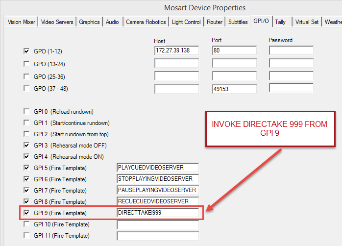

Configuring
The figure below connected GPI 9 to firing DirectTake 999
images/download/attachments/72113904/GPI9.png

  • Assign a DirectTake to a GPI between 5 and 11
  • Restart AvA
  • Trigger this GPI
    This can be done from within AvAutomation by pressing SHIFT+CTRL+<no> where <no> is the GPI number + 1.
    For example, SHIFT+CTRL+0 will invoke GPI 9
  • Verify that the corresponding GPI is executed
  • Directtakes are shown in the AvAutomation Log window (lower left) when taken.

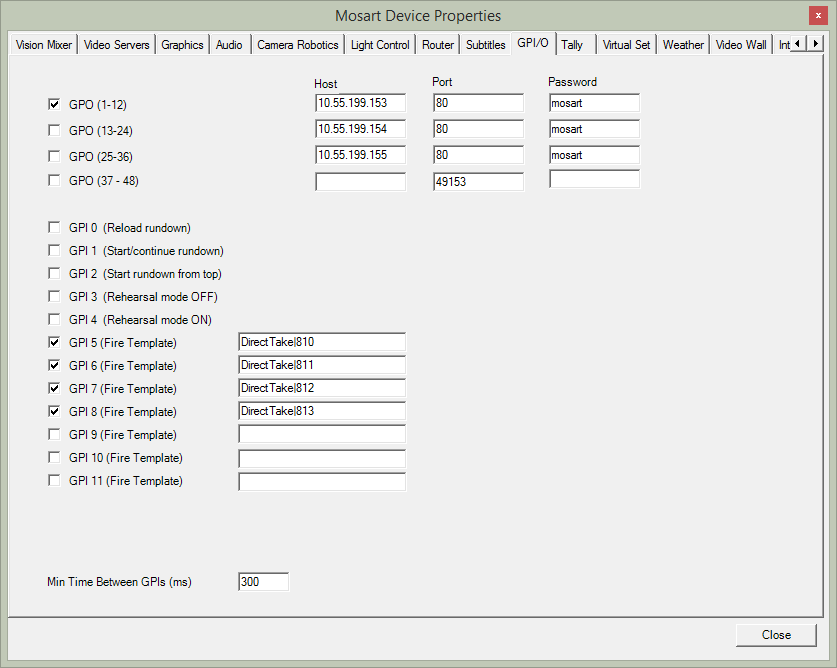

To Trigger DirectTakes Templates via a GPI
  • To trigger a DirectTake (which can then further trigger multiple control commands from a GPI) use the GPI/O tab in AvAutomation > Devices > Properties as shown in the figure below.
    images/download/attachments/72113904/t1.png
Syntax for GPI 5-12
DirectTake|<directtake number>
Note: A GPI/GPO device must first be configured. The configuration of GPI/GPO devices is done in AV Automation Devices GPIO.
