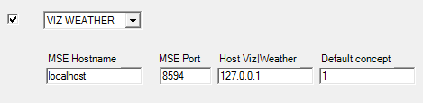

images/download/attachments/50598628/configuration_avauto-weather.png
  • Use Weather: Check to enable control of a weather control.
  • Weather controls: VIZ WEATHER or WEATHER ONE
  • MSE Hostname (Viz Weather): Hostname or IP address to the Media Sequencer controlling the Weather Control engine.
  • Hostname (Weather One): Hostname or IP address of the Borealis Weather One engine.
  • MSE Port (Viz Weather): Port to communicate with the Media Sequencer.
  • Port (Weather One): Port to communicate with the Borealis Weather One engine.
  • Host Viz Weather (Viz Weather): Hostname or IP address to the Viz Weather engine.
  • Default concept: The weather concept to be used as default.
