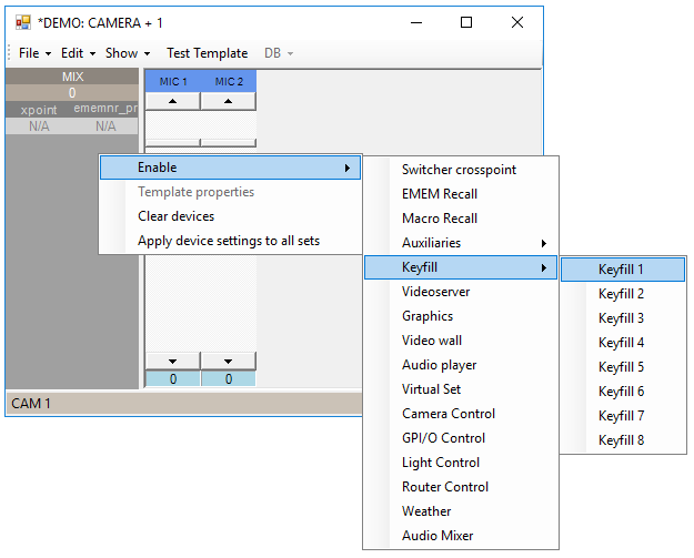

Working with Device Functions

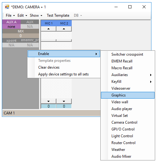

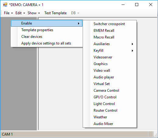

To Enable Device Functions
  1. Right-click in the device Function area.
  2. Select the device to configure from the Enable menu.
    This opens the edit box for the selected device.
  3. Please refer to section Template Device Functions for a list of properties for each device.

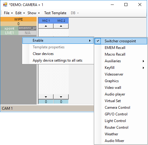

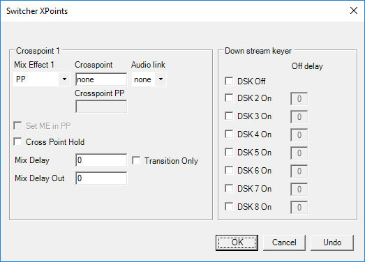

Video Switcher Crosspoint
The video switcher crosspoint enables switching on the video switcher. The A or B bus assignment of the mixer effect (PP/MEx) is automatically handled by the automation.
images/download/attachments/68860726/image2018-5-11_10-27-12.png
Guidelines for Video Switcher Crosspoint Configuration
Item
Description
Mix Effect
Selects which Mix Effect (ME) bank on your vision mixer that you are currently handling.
Note : Newsroom tag available.
images/download/attachments/68860726/image2018-5-11_10-32-5.png
Crosspoint
Crosspoint on the video switcher. Default value: none
  1. Click OK to display a drop-down list of available x-points.
  2. Select from the list.
Note: Newsroom tag available.
Audio link
Default value: none
images/download/attachments/68860726/image2018-5-11_10-33-30.png
Crosspoint PP
If another Mix Effect (ME) than PP is selected, then you can select a crosspoint for program by writing the crosspoint name in the field.
Set ME in PP
If another Mix Effect (ME) than PP is selected, check this box to make that ME the crosspoint for PP. (Checking this box disables XPOINT PP).
Cross Point Hold
Keeps the crosspoint on the selected Mix Effect.
Mix Delay
Offset, in frames, of when to perform the transition.
Mix Delay Out
Delay, in frames, of when to perform the next transition.
Transition Only
Only delay the switcher transition (sub items will perform).
DSK Off
Turns off the Downstream Keyer (DSK) on the video switcher when the template is active in program.
The keyer selected as DSK in the switcher device property (Devices - Properties - Vision Mixer), will be used.
images/download/attachments/68860726/image2018-5-11_10-43-56.png
DSK 2 On, ...,
DSK 8 On
Downstream Keyer (DSK) 2-8 on. Turns on the DSK 2-8 (PP key 2-8) on the video switcher when the template is active in program.
images/download/attachments/68860726/image2018-5-11_10-41-32.png
Off delay
Delay in frames to set the DSK 2-8 off.

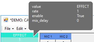

To Define Video Switcher Transitions
  1. Click on the entry to cycle through the transition types; MIX, WIPE and EFFECT.
    images/download/attachments/68860726/image2018-5-11_12-25-27.png images/download/attachments/68860726/image2018-5-11_12-26-41.png images/download/attachments/68860726/image2018-5-11_14-14-31.png
  2. Click directly on the value.
  3. Enter
    1. The default duration for the Mix/Wipe transition, or
    2. The effect name for the Effect transition.
      images/download/attachments/68860726/image2018-5-11_14-20-1.png
The transition is performed with the auto transition functionality in the video switcher.

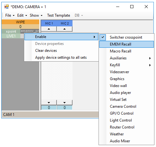

To Open the Video Switcher Register/Timeline Recall
  1. Open Template Editor.
  2. Right-click over ememnr_pr
  3. Select Enable > EMEM Recall
    images/download/attachments/68860726/image2018-5-11_12-6-37.png
  4. Enter or select required values
    images/download/attachments/68860726/image2018-5-11_14-30-0.png

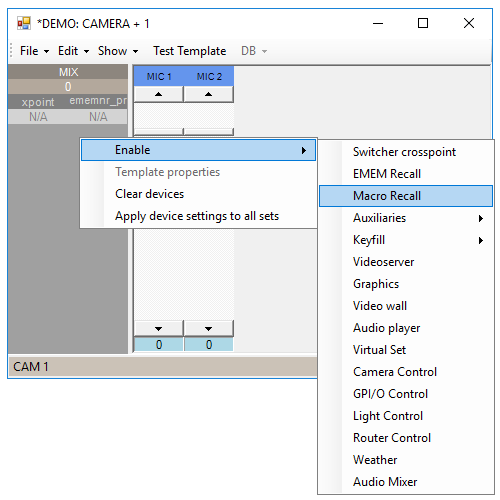

Macro Recall
Macro Recall is available when one of the following vision mixer protocols was selected in the configuration menu AV Automation Devices Vision Mixer.
  • Carbonite
  • GV CPL
  • GV DD35
  • KAHUNA (Kahuna/Kula)
  • SONY SERIAL TALLY
  • vizrt-ip (NewTek\Vizrt Group IP Seriers Mixers (e.g. TriCaster, VMC1)
To Open a Macro Recall
  2. Navigate to Enable > Macro Recall
    images/download/attachments/68860726/image2018-5-11_15-16-30.png
  3. Enter or select required values.
    images/download/attachments/68860726/image2018-5-3_9-27-23.png

Video Switcher Key Bus Delegation (Keyfill)
Video switcher key bus delegation enables routing of internal video switcher signals to the keyers on the different mixer effects on the switcher.
To Enable Keyfill by Bus Delegation
  2. Navigate to Enable > Keyfill > [Keyfill index]
    images/download/attachments/68860726/image2018-5-11_15-23-49.png
    images/download/attachments/68860726/image2018-5-11_15-24-29.png

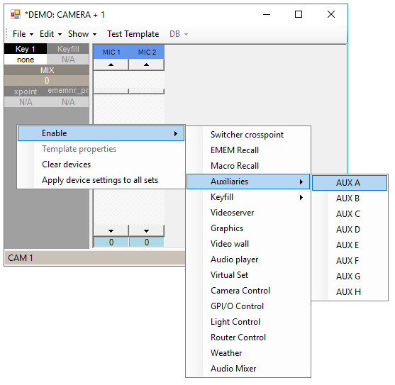

Video Switcher Auxiliary Bus Delegation
Auxiliary bus delegation enables routing of internal video switcher signals to the auxiliary outputs of your video switcher.
images/download/attachments/68860726/image2018-5-11_15-39-20.png
  • Type or select relevant values.
    images/download/attachments/68860726/image2018-5-11_15-39-49.png

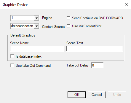

Graphics
The Graphics device enables recall of graphic elements.
images/download/attachments/68860726/image2018-5-11_15-48-57.png
  • Graphic elements are cued (loaded) in Preview and played (started) when taken to Program.
images/download/attachments/68860726/image2018-5-11_15-50-10.png
Guidelines for Graphics Configuration
Engine
images/download/attachments/68860726/image2018-5-14_13-18-58.png
Selects the engine to operate on when using this template based on your configuration.
Content Source
images/download/attachments/68860726/image2018-5-14_12-23-47.png
  • dataconnection: Uses content from the attached graphics database.
  • newsroom: Uses content from the attached NCS.
  • none: Uses content written into the template.
Send Continue on DVE FORWARD
If checked, a continue command is sent together with a DVE Forward command.
Use VizContentPilot
Enable to run this element through a Viz Pilot client. This allows for OnLiveUpdate events in Viz Pilot data elements.
Scene Name
The default scene name is used if not overridden by the NCS.
Scene Text
The default scene text will be used if not overridden by the NCS.
Is database Index
Use take Out Command
If checked, a take-out command is sent when the template status changes from On Air to Off Air.
Take Out Delay
Delay of sending takeout command after template status changes from On Air to Off Air.

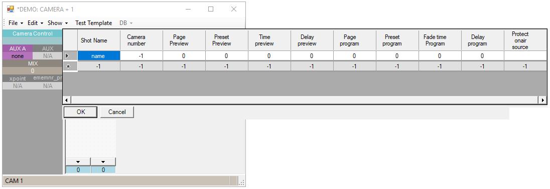

Robotic Camera Control
The camera control device allows for recalling camera shots (and pre-programmed moves) when the template is cued in preview or aired in program. The device editor supports salvo recalls of shots by adding multiple lines for each shot recall.
images/download/attachments/68860726/image2018-5-15_12-47-2.png
The Standard Robotic Camera Control Properties are described below, as well as exceptions for specific camera types:
Guidelines for Standard Robotic Camera Control Configuration
Shot Name
Name of the shot.
Camera number
  • -1 : Shot is sent to all cameras that are not in standby.
  • >=0 : Shot is sent to the camera with the same number.
Page Preview
For recalling a shot/move when the template is cued in Preview.
Preset Preview
Time preview
Time to shot’s position in Preview.
Delay preview
Delay of the move when cued in Preview (frames).
Note: Not recommended for use! Will be deprecated in future versions.
Page program
For recalling a shot/move when the template is aired in Program. See Page Preview for an explanation.
Preset program
For recalling a shot/move when the template is aired in Program. See Preset Preview for an explanation.
Fade time Program
Time to shot’s position in Program. See Time preview.
Delay program
Delay of move in Program (frames).
Note: Only available for Radamec robotics systems
Protect onair source
Protected video switcher cross-point. If the video switcher cross-point is On Air, the shot/move recall will be ignored. This protection may, by configuration for some robots, be confined to Preview and/or Program, and to Cuts and/or Moves.

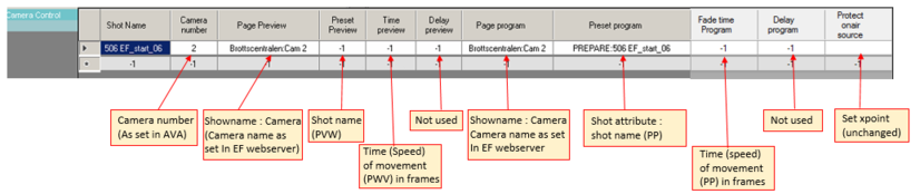

Electric Friends Robotic Camera
For Preview use:
  • Page Preview: Show and Robotic camera name separated with a colon (e.g.: ShowName:Cam 1).
  • Preset Preview [Optional]: Shot name. Shot attributes: prepare, prepareplay and loop. Separated with a colon (e.g.: prepare:ShotName and prepareplay:ShotName).
  • Time Preview [Optional]: Duration for move in frames. The time is rounded up to the nearest second.
For Program use:
  • Page Program: Show and Robotic camera name separated with a colon (e.g.: ShowName:Cam 1).
  • Preset Program [Optional]: Shot name. Shot attributes: prepare, prepareplay and loop. Separated with colon (e.g.: prepare:ShotName and prepareplay:ShotName).
  • Fade time Program [Optional]: Duration for move in frames.The time is rounded up to the nearest second.
    images/download/attachments/68860726/robotic_cameras_electric_friends_template-setup.png

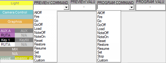

Light Control
images/download/attachments/68860726/templates_light-control.png
Note: The commands to use are driver-dependent and may vary.

PREVIEW COMMAND
Command to use for the light mixer cue to be recalled when template enters preview.
PREVIEW VALUE
Light mixer cue to use when template enters preview. Note: Newsroom tag available.
PROGRAM COMMAND
Command to use for the light mixer cue to be recalled when a template is taken On Air.
PROGRAM VALUE
Light mixer cue to use when a template is aired in program.
Preview Command and Program Command options are available from the drop-down list:

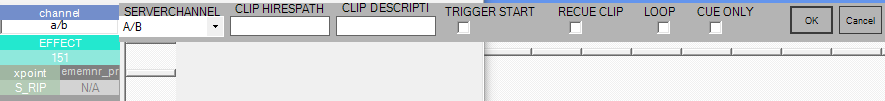

Video Server
images/download/attachments/68860726/image2017-11-29_15-51-47.png
Guidelines for Video Server Configuration
Setting
Description
SERVERCHANNEL
The Mosart video port / port group where the clip is to be played out /recorded.
For recording the corresponding video port has to be part of the “Rec” port group.
Port groups are created as part of the video server configuration in menu AvAutomation > Devices > Preferences.
Configurations are described in AV Automation Devices Video Servers, section Working with Mosart Port Configurations.
Notably, the defined virtual ports are among the available options.
In addition, the non-empty groups (groups with at least one port) are available.
If a group has the same name as one of its ports (as may be the case for the Rec and P groups, if defined), the group as such is not available, but the port is.
CLIP HIRESPATH
The (default) clip ID or name.
Note: Newsroom tag available, meaning that a value from the NCS will override the value specified here.
CLIP DESCRIPT
You can enter a Clip description, however a clip description from the NCS or video server overrides this value.
TRIGGER START
Enables the Trigger start function from control commands, a shortcut or continue point could be set to PLAY the Clip.
RECUE CLIP
In an A/B roll situation, when several Adlibs are played back-to-back, this setting determines how a clip will be restarted after it has been paused.
For example, if Clip A is paused when Clip B is taken On Air, then next time Clip A is taken on the same channel, it can either be played from where it was paused, or be re-cued (played from the beginning).
This is only used for AdlibPix templates.
LOOP
Sets the server port to loop the clip. Beware! Not all video servers can loop.
CUE ONLY
Cues only the clip when the template is in Preview. The template will not start playing the clip when the template is taken.

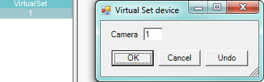

Virtual Set
You can specify camera to take in a virtual set.
images/download/attachments/68860726/templates_virtual-set.png
  • Insert the camera number in the virtual set that is to be taken when the template is taken to Program.

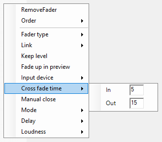

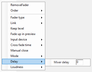

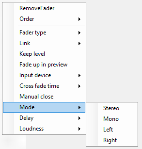

Audio Settings
  • The main level for the fader is set by dragging the notch or clicking the arrows.
    The default fader level when adding a new fader is 0 dB.
  • To set level 2 of the fader press SHIFT while dragging.
    A tool-tip opens to signal the editing of the level 2 fader level.
  • To set level 3 of the fader press SHIFT+CTRL while dragging.
    A tool-tip opens to signal the editing of level 3 fader level.
    Level 3 is the mute level of the audio fader.
To Add Audio Faders
  1. Add audio faders to the template by right-clicking in an empty part of the audio fader area and selecting Add fader.
  2. Set the audio mixer crosspoint from the drop-down menu by clicking the label at the top of the fader.
To Remove a Fader
  • Right-click over the fader and select Remove fader.

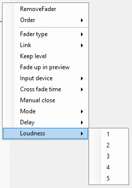

To Configure a Fader
  • Right-click over the fader to open the context menu and follow the Guidelines below.
Guidelines for Audio Properties Configuration
Remove Fader
Removes the fader from the template.
images/download/attachments/68860726/image2018-5-4_14-30-50.png

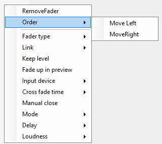

Order
Re-arranging the order:
  • Move Left
  • Move Right
images/download/attachments/68860726/image2018-5-4_14-47-19.png
Fader type
Action: When a fader control is set as an action fader, the controls define whether the fader is enabled or disabled.
Level: For normal operation.
  • Action
  • Level
images/download/attachments/68860726/image2018-5-4_13-39-26.png
Link
Assigns a video/audio link group to this fader.
  • none
  • 1
  • 2
  • 3
  • 4
  • 5
  • 6
  • 7
  • 8
images/download/attachments/68860726/image2018-5-4_14-51-12.png
Keep level
Keeps the fader level until manually changed.
Enabled to let the automation open the audio fader, leaving it open until the operator closes it with the Fade audio function in the Viz Mosart client,
or closes it from another template.
images/download/attachments/68860726/image2018-5-4_14-53-2.png

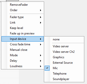

Input device
Sets the type of the audio fader.
The setting is used in combination with primary template type and On Air status to identify which fader should be treated as secondary audio.
This special handling is applied to the types below:
  • none: No special treatment.
  • Video server: The fader controls a video server channel audio output.
  • Video server Ch2: The fader controls a second video server channel audio output.
  • Graphics: The fader controls audio output from the Graphics Engine.
  • External source: The fader controls an external audio source.
  • Mic: The fader controls a studio microphone.
  • Telephone: The fader controls a telephone hybrid.
  • Soundplayer: The fader controls the Mosart Audio Player output.
images/download/attachments/68860726/image2018-5-4_10-21-18.png
Crossfade time
Sets the in and out crossfade time for the fader.
  • In
  • Out
images/download/attachments/68860726/image2018-5-4_15-2-49.png
Manual close
Select to ignore sending Close-level commands to audio mixer.
When selected, sending the Take out for the fader at the end of the element is ignored; The fader has to be manually taken down.
images/download/attachments/68860726/image2018-5-4_15-11-18.png
Mode
Only for Studer Vista and Lawo!
Sends the chosen value to the mixer board for the audio fader.
  • Stereo
  • Mono
  • Left
  • Right
images/download/attachments/68860726/image2018-5-4_15-12-12.png
Delay
Gives a delay value for that audio fader that will be sent to the audio board.
  • Mixer delay. Default: 0
images/download/attachments/68860726/image2018-5-4_15-13-43.png
Loudness
Sends chosen recall value to send to the Junger audio processor.
  • 1
  • 2
  • 3
  • 4
  • 5
images/download/attachments/68860726/image2018-5-4_15-15-45.png
