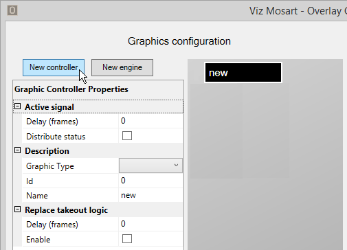

  1. Open the Overlay Graphics Configuration window by going to Settings > Properties.
  2. Click New controller.
    images/download/attachments/50598316/configuration_mmoverlay-newcontroller.png

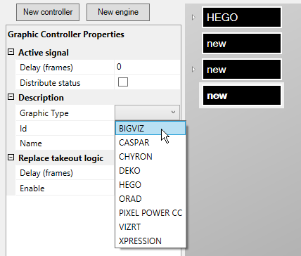

  3. In the Graphic Type drop-down, select the type of graphics system you are using (see Overlay Graphics Types).
    images/download/attachments/50598316/configuration_mmoverlay-newcontroller2.png
  4. Set the Controller properties according to the selected Graphic Type. See corresponding section for each graphic type.

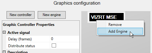

To Add a New Engine
  2. In the list of controllers, select the black box of the Controller you want to use.
  3. Click New engine, or right-click the controller and select Add engine.
    images/download/attachments/50598316/configuration_mmoverlay-newengine.png
  4. Set the Engine properties according to the selected Graphic Type. See corresponding section for each graphic type.
