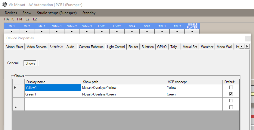

Shows Tab
images/download/attachments/72109153/AvA.PNG
It is mandatory to have an exclusive (non-null) value for Show path configured!

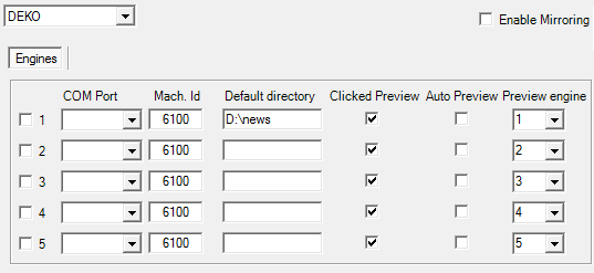

Deko Settings
images/download/attachments/72109153/configuration_avauto-graphics-dekos.png
  • Engines: Enables the connections to the Deko engines. Viz Mosart supports five graphics engine connections when checked.
  • COM port: Serial ports connected to the Deko engines.
  • Mach. Id: Machine IDs of the Deko engines. Valid range is 0 to 9. Leave blank to send global commands.
  • Default Directory: The folder on the Deko engine that contains the graphics templates.
  • Clicked Preview: Click on full-screen graphic element to send to the Preview engine.
  • Auto Preview: Automatically send full-screen graphic element to the Preview engine.
  • Preview engine: Defines the Deko engine number.

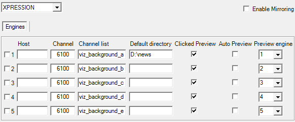

XPression Settings
images/download/attachments/72109153/configuration_avauto-graphics-xpression.png
  • Engines: Check to enable the connections to the XPression engines. Viz Mosart supports five graphics engine connections.
  • Host: Hostname or IP address to the XPression engine.
  • Channel: Output channel from the XPression engine. Use 0 for default channel.
  • Channel list: Output channel(s) to be cleared when Channel is set to 0.
  • Default directory: The folder on the XPression engine that contains the graphics templates.
  • Preview engine: Defines the XPression engine number.

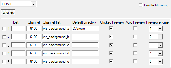

Orad Settings
images/download/attachments/72109153/configuration_avauto-graphics-orad.png
  • Engines: Check to enable the connections to the Orad engines. Viz Mosart supports five graphics engine connections.
  • Host: Hostname or IP address to the Orad engine. Include the IP port number, for example 172.20.51.55:10001.
  • Channel: Output channel from the Orad engine. Use 0 for default channel.
  • Default directory: The folder on the Orad engine that contains the graphics templates.
  • Preview engine: Defines the Orad engine number.

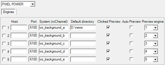

Pixel Power Settings
images/download/attachments/72109153/configuration_avauto-graphics-pixpow.png
  • Engines: Check to enable the connections to the Pixel Power engines. Viz Mosart supports five graphics engine connections.
  • Host: Hostname or IP address to the Pixel Power engine.
  • Port: Port to communicate with the Pixel Power engine.
  • Default directory: The folder on the Pixel Power engine that contains the graphics templates.
  • Preview engine: Defines the Pixel Power engine number.

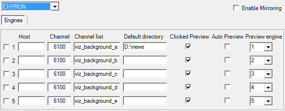

Chyron Settings
images/download/attachments/72109153/configuration_avauto-graphics-chyron.png
  • Engines: Check to enable the connections to the Chyron engines. Viz Mosart supports five graphics engine connections.
  • Host: Hostname or IP address to the Chyron engine.
  • Channel: Output channel from the Chyron engine.
  • Default directory: The folder on the Chyron engine that contains the graphics templates.
  • Preview engine: Defines the Chyron engine number.
