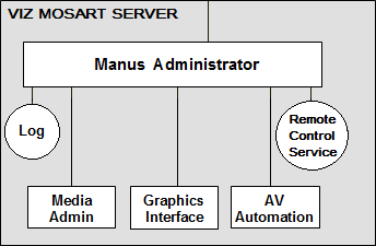

The Viz Mosart Server is split into four main components plus two services, each handling an important role for the system to function. Splitting the system into components allows greater flexibility in handling a variety of broadcast devices and productions.
A typical Viz Mosart Server installation contains the following applications and services.
  • Manus Administrator (console application): Handles the connection to the Newsroom Control System (NCS).
  • Media Administrator (console application): Application for monitoring media objects (clips) referenced in the current rundown. Supports the media search option used in the Viz Mosart GUI.
  • Overlay Graphics Interface (Windows application): Application for controlling and monitoring overlay graphics.
  • AV Automation (Windows application): Application for controlling all other external broadcast equipment.
  • Log Service and Log Viewer (Windows service): Service used for generating Viz Mosart command logs. Automatically installed with Viz Mosart Server and the Viz Mosart GUI.
  • Remote Control Service (Windows service): Service used for all external PCs, like GUI and Timing Display, to connect to the Viz Mosart Server. Automatically installed with the Viz Mosart Server.

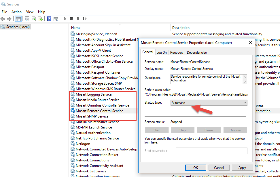

The RCS (Remote Control Service) and Log Service run as Windows services and are therefore not available for easy visual inspection. It's recommended to make these services start automatically when Windows starts up. One easy way to do this is to use the Windows services application (Start button > Services): locate the required services in the services window, right-click the service and make sure its properties are set to Automatic as shown in the screenshot below:
images/download/attachments/41799878/MosartServices.png
If you prefer the command line, you can easily inspect and start/stop services from Powershell. Start an elevated Powershell (Admin) session via Start > Powershell > right-click and select Run as administrator. In the example below, the Mosart Logging Service and RCS are running, while other Viz Mosart services are stopped:

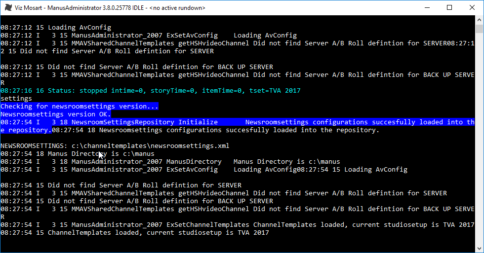

Manus Administrator
images/download/attachments/41799878/Manus_console.png
Manus is short for manuscript, the script originating from the Newsroom Control System (NCS). Manus Administrator is the central Viz Mosart application that controls the current rundown in the Viz Mosart GUI and receives rundowns from the attached NCS. It issues events according to the different story items in the rundown and is dynamically updated when changes are made in the NCS. Although Manus Administrator receives information from the NCS, it does not send updates back - this prevents rundown control conflicts between the systems.
The Manus Administrator handles the connection to the NCS, and executes commands at the appropriate time according to GUI input and template configuration.
The Manus Administrator runs as a live console application and responds to free text commands. For improved execution speed, Manus Administrator should be run in the background or be minimized.
Variants
Manus Administrator has variants with slightly different settings that suit different broadcast environments. During installation, select the Manus Administrator appropriate to your environment:
  • MMConsoleAdmin_2007 for iNews FTP Newsroom connections
  • MMConsoleAdmin_MOS for MOS Newsroom connections
    Note: Manus Administrator is sometimes also referred to as MMConsoleAdmin, ManusAdmin, ManusAdministrator or just Manus.

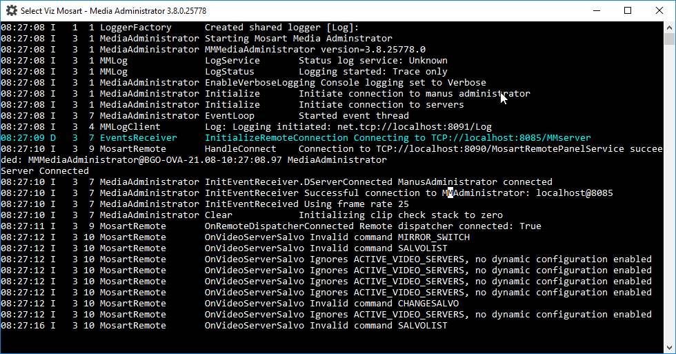

Media Administrator
images/download/attachments/41799878/MediaAdmin_console.png
The Media Administrator (MMMediaAdministrator) handles the database connection to your video servers. This application references the database to provide a current clip list within the Viz Mosart timeline, without making changes.
Mainly used for monitoring and searching video clips on connected video servers, The Media Administrator:
  • Is responsible for reporting status for all clips in the current rundown to the Manus Administrator - typically whether a clip is present and properties like clip duration. The clip status for video servers is displayed in the Viz Mosart GUI as horizontal bars. A light-blue bar indicates a clip that is present on the video server, whilst a checkered bar indicates a non-existing clip. Clip length is shown by the length of the horizontal bar in the Viz Mosart GUI. For other media objects, Viz Mosart may present clip status in other ways.
  • Makes it possible to search for clips on the video server. This functionality is used by the Viz Mosart media search window, making it possible to add clips to the rundown without the use of an NCS. You can also search for other media objects like subtitles, graphic elements, and audio files.
    The Media Administrator runs as a live console application and responds to free-text commands. It should be run in the background or minimized for improved execution speed.

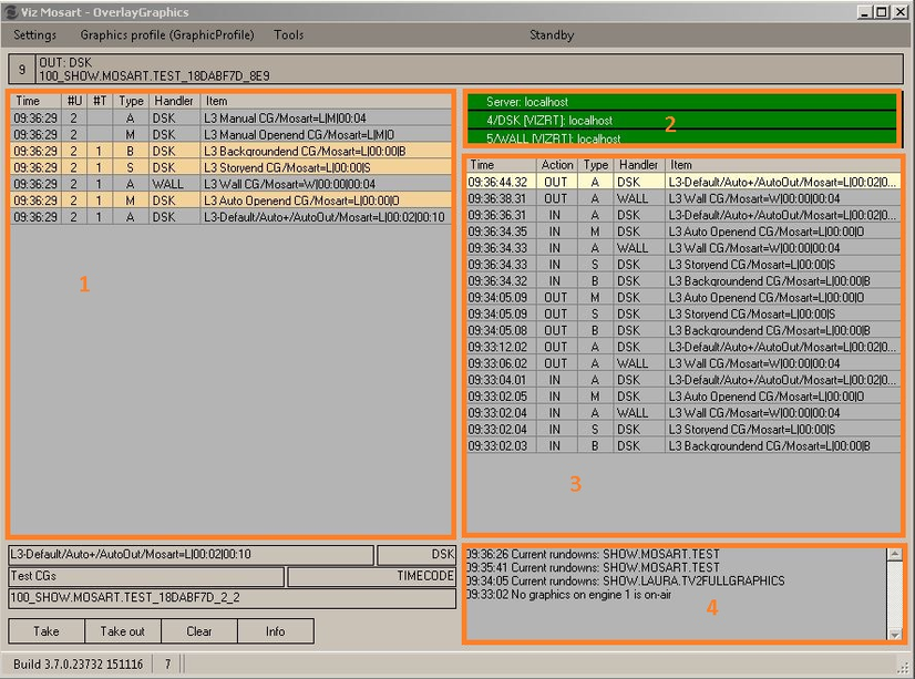

This is used for controlling and monitoring overlay graphics for graphics engines.
The two overlay graphics interfaces are:
  • OverlayGraphics Interface (recommended).
  • Trio Interface (to be deprecated, kept for backward compatibility only).
    Note: An overlay graphics interface is only used for overlay graphics. Full-frame graphics are controlled through AV Automation.
images/download/attachments/41799878/about_mmoverlay-app.png
The Overlay Graphics Interface is used for controlling and monitoring the overlay graphics for all Viz Mosart approved graphics engines. Configure it using Overlay Graphics Configuration. For a list of supported graphics devices, see Overlay Graphics Types.

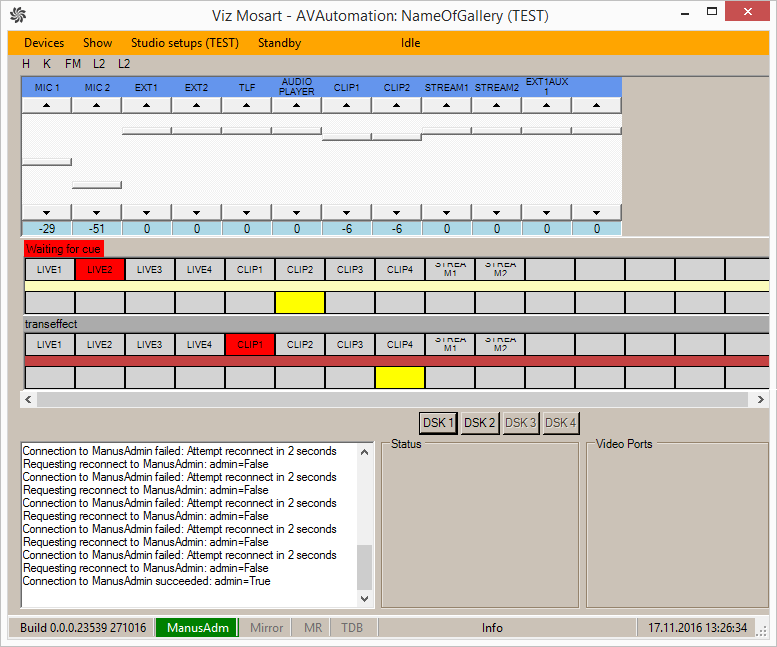

AV Automation
images/download/attachments/41799878/about_avautomation-application-resized.png
AV Automation (MMAVAutomation) controls all Viz Mosart broadcast devices with the exception of Overlay Graphics engines. Full-screen graphics is also controlled here.
Commands are issued to each device either on the fly through the Viz Mosart GUI, or as pre-determined by the rundown submitted from the NCS.
All device commands are stored as predefined Viz Mosart templates in the Template Editor and are saved in C:\channeltemplates or in a template database.

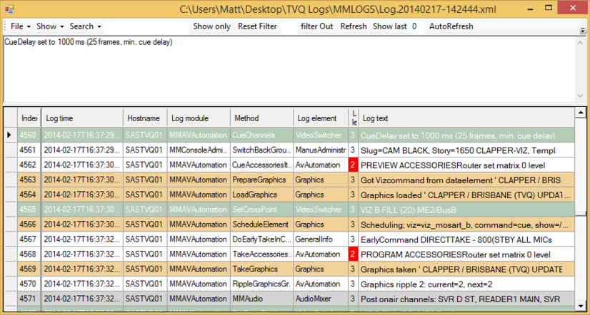

Log Service
This is used for generating Viz Mosart command logs and is automatically installed together with the Viz Mosart Server and the Viz Mosart GUI.
Log Viewer
images/download/attachments/41799878/about_log-viewer-icon.png
Log Viewer is used to decipher Viz Mosart logs. It is stored as an XML file once published, and as a .log file while actively running.
The log entries are color-coded to allow for quick command visualization in the file. Microsoft Excel may also be used to display log files (XML), and lets you use several layers of filtering and plot graphs.
images/download/attachments/41799878/about_log-viewer-window.png
