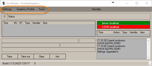

A menu bar at the top offers Settings, Graphic Profile, Tools and Standby.
images/download/attachments/68863552/GO1.png

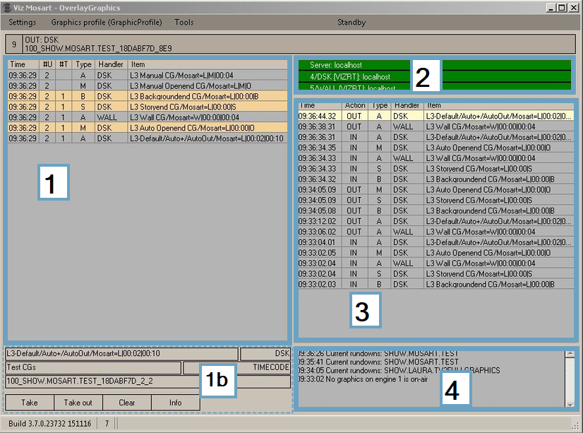

The Overlay Graphics interface consists of four main areas ([1] to [4] in the illustration).

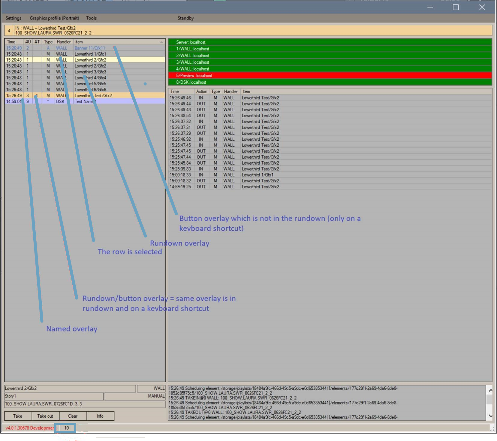

A status bar at the foot of the UI provides information on product version number and the total number of graphics in Viz Mosart (rundown overlays + named overlays + button overlays. 7 in the example above).
images/download/attachments/68863552/OL.png

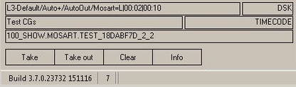

[1b] Details of a Selected Graphic from the List of Overlay Graphics
Selecting an overlay graphic from the list displays further details:
images/download/attachments/68863552/l3.png
Explanation of Details
Element
Description
images/download/attachments/68863552/graphicTitle.jpg
Graphic title
images/download/thumbnails/68863552/handlerName.jpg
Handler name (the destination or the channel for this graphic)
images/download/thumbnails/68863552/graphicType.jpg
Graphic description
Graphic type (see [1] above)
images/download/attachments/68863552/mosartGraphicID.jpg
Graphic ID
This is the Viz Mosart Graphic ID, not the graphic ID from graphic database (Graphic Hub/Oracle)
images/download/thumbnails/68863552/actionButtons.png
Action Buttons
Take: Takes graphic on air
Take out: Takes graphic off air
Clear: Takes out all taken graphics
Info: Opens an editor window where the graphic MOS item can be changed and updated

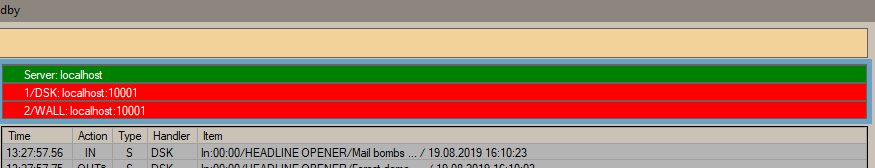

[2] Server Status
images/download/attachments/68863552/status.png
[3] General Log
The center right contains a log of all actions performed on the overlay graphics either triggered by Viz Mosart or by clicking Overlay Graphics buttons.
To clear this area, double-click inside it.
[4] Event Log
