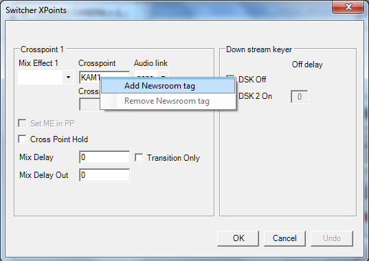

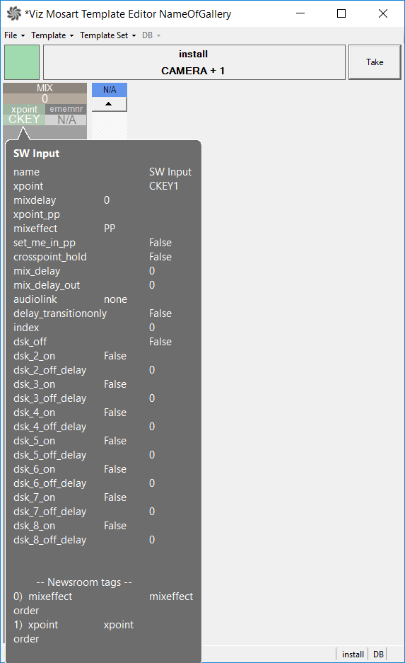

To Add a Newsroom tag
  • Refer to section Working with Device Functions, which lists the properties of the device where you want to add the Newsroom tag (e.g. the 'Switcher XPoints' as shown below).
  • Right-click the field (e.g. Crosspoint). A pop-up menu appears:
    images/download/attachments/72108982/nrT.png
    (If the field already has a Newsroom tag, there will instead be a menu option Change Newsroom tag, and the Remove option will be enabled. Please note that not all template fields support Newsroom tags. When right-clicking a non-supporting field, a pop-up menu may or may not appear. If it does, it will not contain an Add Newsroom tag option).
  • Select Add Newsroom tag.

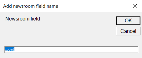

    A dialog menu appears:
images/download/attachments/72108982/image2019-8-20_8-53-58.png
Please note that a default name may be given.
  • Enter or change the Newsroom tag name, and click OK.
    Note: Avoid using any special characters in Newsroom Tag naming
  • Close the device properties window (e.g. the 'Switcher XPoints' as shown above).
  • To verify, hover-over the device details. The Newsroom tag(s) are presented at the bottom of the panel.
images/download/attachments/72108982/image2019-8-20_12-11-31.png

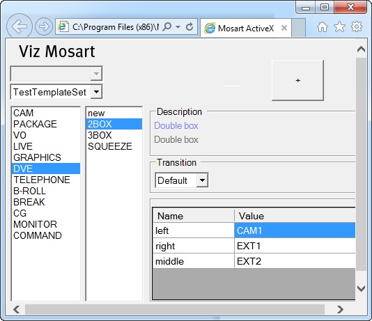

  4. To verify, open the Activex in the NRCS, and observe that the tag order is as set in the previous step:
    images/download/attachments/72108982/templates_activex2.png

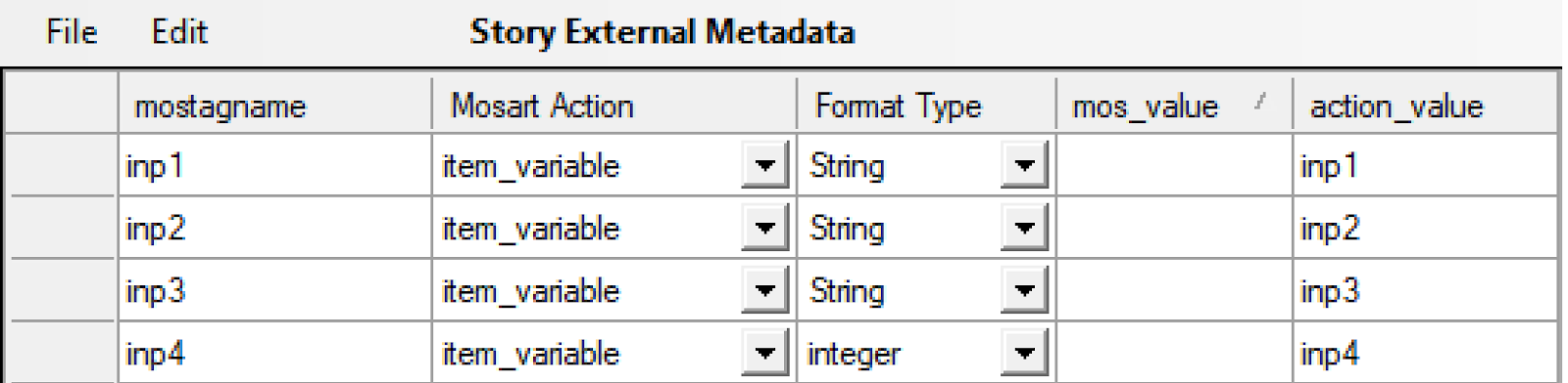

  4. In Viz Mosart External Metadata
    1. Add the new ENPS field as, for example, an item_variable.
    2. There is also a story_valuable available, but using this action value will affect all items in the story (the Newsroom tag binds to all primaries in that story).
    3. The target here should be the first primary item in a story.

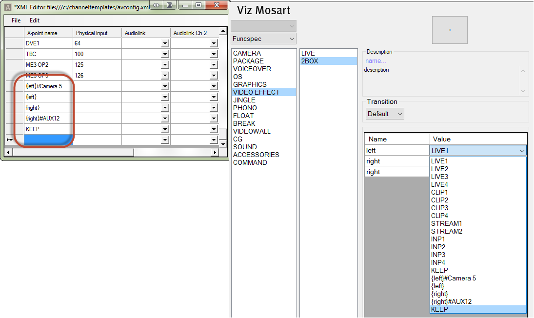

Adding inheriting values to the lists defined in AV Automation's Audio and Video Setup
As mentioned in the introduction above, a Newsroom tag may have a list being one of those defined in AV Automation's Audio and Video Setup. Special values as defined above ('KEEP'', {name}', and '{name}#default') may actually be added to these lists, making the available for selection both in the template editor and in the ActiveX.
The following figures five such values added to the Video Config list, and how these values appear in the ActiveX:
images/download/attachments/72108982/nTag0.png
Explanation:
  • {left}#Camera 5 – Use the value of the last Newsroom tag {left} or “Camera 5” if no such Newsroom tag exists.
  • {left} - Use the value of the last Newsroom tag {left}. Nothing happens if no such Newsroom tag exists
  • KEEP – Special configurable word that means keep existing value of the corresponding Newsroom tag. (In the ActiveX example "left")

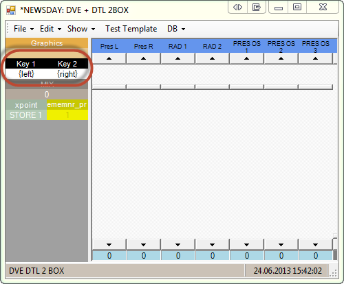

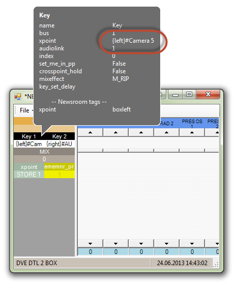

DVE Template with inheritance
A DVE 2BOX template where the left and right input may be inherited from sources within the same story
images/download/attachments/72108982/NewsRoomTag2.png
In this template the values for Key 1 and Key 2 are:
Key 1 = {left}#Camera 5
Key 2 = {right}#AUX 12
This means that Key 1 will be either the current value of a Newsroom tag named left within the same story or “Camera 5” if no such Newsroom tag exists.

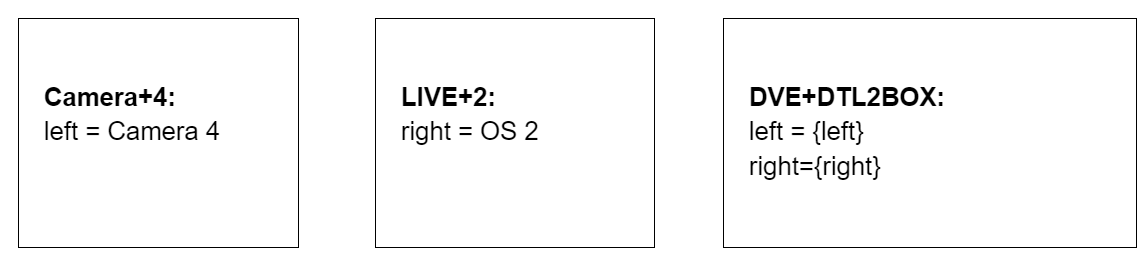

Timeline Example
images/download/attachments/72108982/image2019-7-29_15-20-43.png
In the figure above three templates are placed in a timeline:

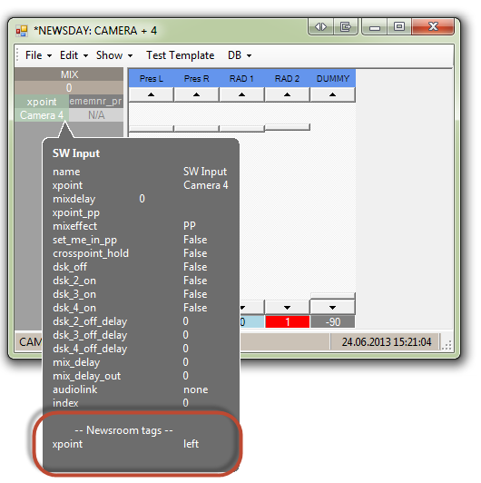

  1. Camera+4: Where xpoint is set to “Camera 4” with Newsroom tag = “left”
    images/download/attachments/72108982/NewsRoomTag5.png

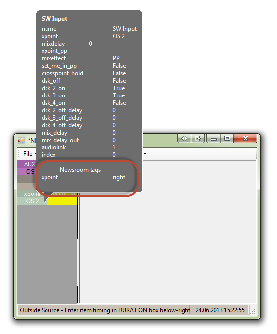

  2. Live+2: Where xpoint is assigned to OS 2 with Newsroom tag = “right”
    images/download/attachments/72108982/NewsRoomTag6.png
    Note: The Newsroom tag here is entered to make it possible for later templates in the story to inherit the value. Adding a Newsroom tag here will also expose this value to the ActiveX
  3. DVE+DTL2BOX where left and right inputs are set to inherit Newsroom tag {left} and {right} respectively.
    images/download/attachments/72108982/NewsRoomTag7.png
    In this example, the left and right inputs are inherited from previous templates in the same story exposing Newsroom tags with the same names.
    Note: Here, no default values are given., so nothing will happen if no values have been assigned to the left and right Newsroom tags
