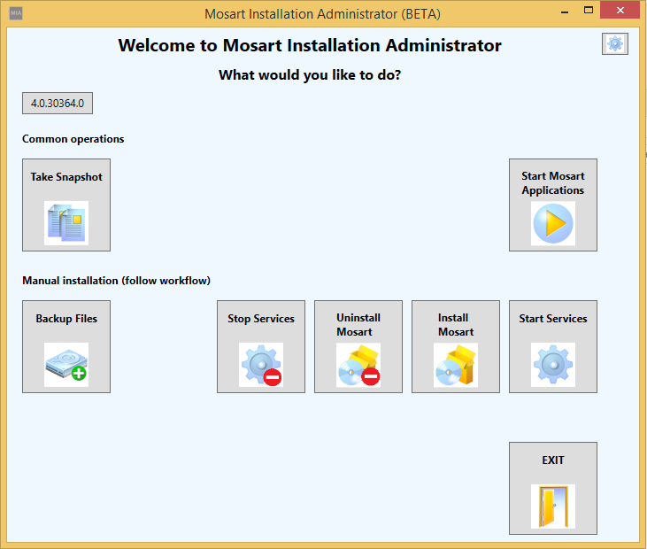

Viz Mosart Installation Administrator Interface
images/download/attachments/50598204/MIA-4.0.0.30364.PNG
The MIA utility assists in installation and upgrade of Viz Mosart.
The various tools are described below.

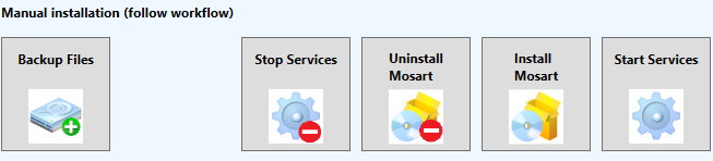

Semi-Automated Installation
images/download/attachments/50598204/MIA-4.0.0.30364-Manual-Installation.PNG
The Viz Mosart Installation Administrator can run a semi-automated installation process.
The buttons above are placed in the order you would normally progress through when upgrading an existing Viz Mosart installation.
New Installs
If Viz Mosart has not been installed before and installer files are in the correct installation location, begin from the Install Mosart button.
Upgrades
Follow a five-step process running from left to right when performing a semi-automated upgrade.
Note: If Viz Mosart has previously been manually installed on the system you are using without using the Viz Mosart Installation Administrator, the user must uninstall Viz Mosart manually through Windows’ Uninstall or change a program before using the installation assistant. This is due to a filename mismatch in the Windows Registry and installation assistant that makes MIA unable to locate previous manually installed Viz Mosart Applications.

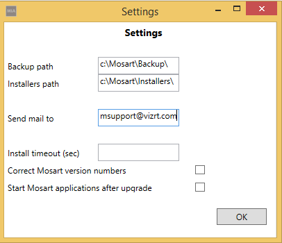

Settings
images/download/attachments/50598204/installation_mia-settings.png
Settings are accessed by clicking on the cog-wheel icon, at the top right of MIA.
The screenshot below shows default settings.
images/download/attachments/50598204/MIA-4.0.0.30364-Settings.PNG
Note: Any paths not found in MIA settings can be manually changed by editing the file:
C:\Program Files (x86)\Mosart Medialab\Mosart Installation Administrator\MosartInstallationAdministrator.exe.config
  • Backup path: Defines the path to where the installation assistant places backup files.
  • Installers path: Defines the path to where the installation assistant should look for installation files.
  • Send mail to: Defines the e-mail address where error reports should be sent when troubleshooting.
  • Install timeout (sec): Viz Mosart Services attempt to start/stop for the defined number of seconds.

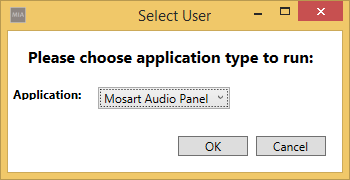

  • MIA provides an quick launch of any installed Viz Mosart application. This feature only allows for one application to be started at a time.
    images/download/attachments/50598204/installation_mia-select-user.png

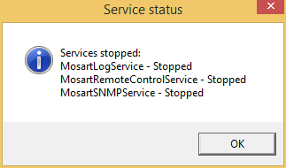

  • Pressing this button stops all Viz Mosart services installed, with a timeout of six seconds.
Tip: The timeout length can be adjusted in the installation assistant Settings.
  • A dialog box appears with the current service status:
    images/download/attachments/50598204/installation_mia-stop-message.png
  • Repeat as necessary.

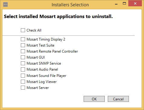

  • Pressing this button displays all installed Viz Mosart Applications.
    You can then select one or all of the applications to uninstall.
  • The MIA does not delete desktop shortcuts.
    Existing shortcuts can be reused on completion of an upgrade.

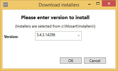

  1. Pressing this button displays all available Viz Mosart installers found in the configured Installers path (see Settings).
    The default is C:\Mosart\Installers.
    images/download/attachments/50598204/installation_mia-install-version.png
  2. Select the Viz Mosart version you want to install, and click OK.

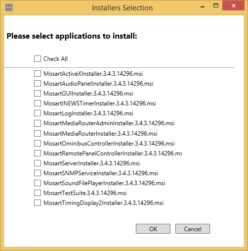

    The next screen shows applications found in the installation folder. You can select one or all of the installers to run.
    Note that if the installation folder is not named purely with the Viz Mosart version number, like the example 3.4.3.14296 above, MIA will fail to show the below list of installers.
    images/download/attachments/50598204/installation_mia-install-selection.png
