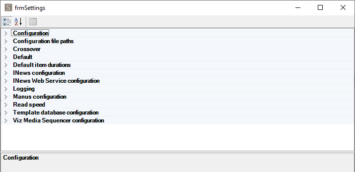

Settings Editor iNews
To open the frmSettings XML Editor, open the Manus Administrator console, then type settings followed by ENTER.
images/download/attachments/72106430/image2019-10-2_15-58-48.png
